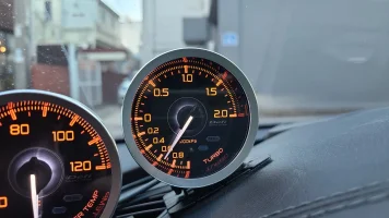

what is your guys negative boost pressure at idle for Lozic ECU tune on G70 or stinger 3.3t?

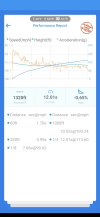

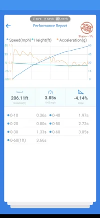

Just installed the TCU tune and gave it a try. Settings are pressure 2, shift point minus 5% and torque limits off. I guess I'm not generally surprised at the performance as pretty much everyone's described it ad nauseam by now but works exactly as advertised. 3.85s 0-60 and 12.01s@113.6mph 1/4 mile (invalid by draggy due to -1% slope, but also my pavement isn't exactly smooth and even a bit damp). That's on stock all seasons with 11k miles, in the winter, pretty much cold.
At pressure 2, I really do like the behavior of the transmission. Overall it's fast but not too aggressive. My wife doesn't notice a difference when driving in comfort mode. I love how it holds gears higher in sport mode. If you're on it, then it will even downshift as soon as it has revs available below redline in the lower gear. The downshift from second to first is usually pretty great (in fact, downshifting in general is great. It needs a lot less brakes because of how much engine braking it uses), but indeed, sometimes it can be a little bit harsh to the point of mildly breaking traction in the rear wheels. It's not a deal breaker for me I don't think.

You should be getting mid 3s or better time with the ecu and the tcu now. But yeah, weather and especially road conditions matter.
Glad you like the tcu though!
Oh yeah. Quite happy with the way it works. I haven't really dialed in the launch yet, either. I just let go of the brakes as soon as I saw positive pressure on the mfd gauges screen and the car didn't skip a beat. My second draggy run I overcooked the boost and started spinning before I let off the brakes. I just pretty much strafed sideways all 4 spinning. Still got 4.07 and 12.2 lol
