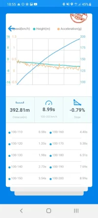

I only see 1/4 mile and 0-60 times in here
But what I am really interested in, are the high speed roll races
So far I only saw a couple dragy runs 100-200 km (60-130)
And those were worse than what a jb4 map2 can deliver
The lowest I’ve seen with this tune was 10.30
We’ve achieved 9.3 with jb4 map2 and on 95RON pump fuel (90-91AKI octane)

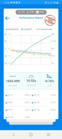

First try at a 60-130

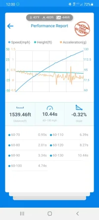

I did my 2 with Dragy, done from standing still in "Auto". But you can do it whatever you think is best.
Good time! We have "about" the same. But like weather, temp, tyre size and other conditions can vary. So it will say that power is "about" the same, like 400 hp in Mustang for me, probably some more for you if you Dyno in Dynojet. Seems like LAP3 guys will beat us...
Thanks, maybe someday I'll get her on a dyno. But it's not on my priority list for now. I'm happy with the times I'm getting from the ECU. But I'm still wondering what kind of improvements I'll see once my TCU is installed. I've been waiting forever for it. As for Lap3, I would guess that their stage 1.5 ECU tune (93 octane 410-430whp per their website) would be very close to my 1.5 bar 93 octane Lozic ECU. But the Lap 3 ECU is $2500 once you add a few options that Lozic doesn't charge a extra cent for. For me the Lap3 isn't worth the extra $1050. But I'm sure other people would disagree with me.
