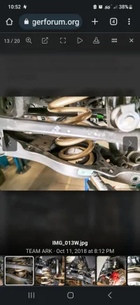

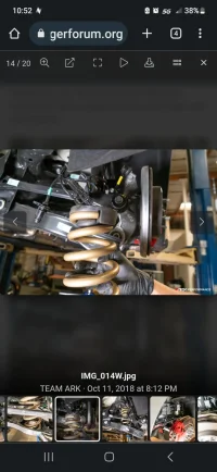

All of this has anybody looked at the spring pocket yet to make sure it's seated correctly. You can just take the tire off and a flashlight and see that
He claimed he looked today when he was under it, never took the wheel off tho... I may have to do this myself... Is it easy to tell?
@socalvn thats what i was wondering too.
@Schroedes its easy to see. And like i mentioned earlier today you can see the spring seats. Id check jjst because
So the springs actually twist into the seats?
Yes that's the best way to describe it. A spiral incline in the rubber seat attached to the control arm. Let me check i may have one for pics
2 pics are from the thread i shared with you. Others are mine out of the car. Hopefully this helps

I looked up in there and both springs look to be butted against that rubber stopper... Tech is convinced I have a bad strut but idk if I believe that, I would think it would exhibit other symptoms
