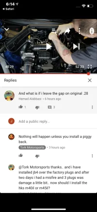

I think in his response he said he cracked plugs 2 days after installing a jb4. I dont think theres an assumption there? Am i reading it wrong?
Hamad Alabbasi
6 hours ago
And what is if i leave the gap on original .28
Tork Motorsports
3 hours ago
Nothing will happen unless you install a piggy back.
Hamad Alabbasi
3 hours ago

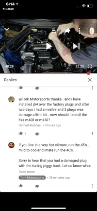

@Tork Motorsports thanks.. and i have installed jb4 over the factory plugs and after two days i had a misfire and 3 plugs was damage a little bit.. now should I install the hks m40il or m45il?
Tork Motorsports
27 minutes ago
If you live in a very hot climate, run the 45's... mild to cooler climate run the 40's. Sorry to hear that you had a damaged plug with the tuning piggy back. Let us know when you want to run a proper ECU tune."
Stock Spark Plugs are gapped from 0.034-0.036 so he would have had to of gapped them already once.

I just did. Again .028 ist not the stock gap and they didnt close .04-.06 on their own in two days with a jb4? Or can the piggyback gap your plugs in the coils for you :D Is that in the V8 Firmware update Terry?
Hamad Alabbasi
6 hours ago
Tork Motorsports
3 hours ago
Hamad Alabbasi
3 hours ago
Tork Motorsports
27 minutes ago
The problem is he said hes running stock plugs at their original gap. That tells us he hasn't re-gapped his stock plugs, agree?
We know the stock plug and gap isn't 028, but that doesn't mean he does.
Tork knows that if the dude was running the stock plugs at original gap he WASN'T running 028.

I dont think anything was misleading. Based on what we KNOW stock gap is and based on what he said his gap was at I think its safe to say somewhere somehow they were gapped.
I think maybe you might be assuming now? Just saying. He said hes plugs are at 028 and i doubt he jsut pulled a random number out the sky. I would ASSUME like we all are now that some where they were gapped down from OEM spec.
.028 Gap with tune on the stock heat range - wouldn’t be my comfortable range. Every 100hp should be one step cooler. If I load Map 3... I’m not liking my Odds with a JB4 or Tork’s at a .028 on stock plugs.
Yes I agree .028 should not be fine for most all piggybacks. I think some request .022
