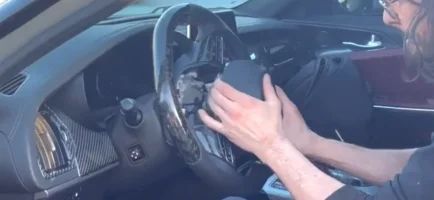

I’ve done quite a bit of automotive electronics over the years but I am sufficiently inexperienced with airbags that I’m overly cautious opening up steering wheels.
I would like to check voltages of the steering wheel button illumination wires (3 - B/W & 4 - Y) while operating the dimming switch. This requires the battery to be connected and the airbag out of the way at least a few inches. The airbag wires look long enough to enable this.
First step to REMOVING the airbag is to disconnect the battery. This makes obvious sense if I’m going to manipulate the electronics to the airbag itself, but if I’m only moving the CONNECTED airbag a few inches out of the way…is disconnecting the battery required?
Thanks.
Negative! airbag does not need to be unplugged to probe around. It has enough slack to hang just use a microfiber to lay it so you won't sctech your steering wheel. But just to let you know, the illumination wires only work with the headlight switch. So if you plan to connect it to those wires the steering wheel will only work with the parking lights/headlights.

Right. Airbag does not need to be unplugged. But does the battery need to be disconnected?
I mean to be on the safe side yes! but honselly not needed if your being careful. Because you need the battery connected for testing obviously.
