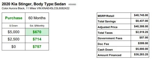

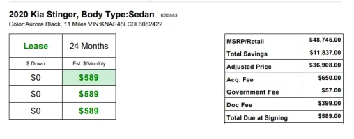

hey stinger friends. got a lease offer this evening and curious if someone can help me understand it. (i'll even include the screenshot of their purchase offer) so I'm assuming the "adjusted price" is what the adjusted cap cost would be on the buyer order? the folks who have leased before - does this breakout look familiar? this is a 2020 GT1 AWD and the current lease rebate should be $7,900 which means they're taking off $3,937 as a dealer discount, which is 8% off MSRP ($3,937 +$7,900 = $48,745). one thing to note is I dont see tax in the breakout - i'm assuming that's because this dealer is located in NH where there is no sales tax, but my car would be registered in MA where I live so I'm assuming I'd need to add on 6.25% sales tax to this equation to calculate if the buyout option is worth it? Thanks!

8% is ok, not great. See if you can get another dealer to beat it then play them off each other. 10% or more would be great, or you can let the dealer know: their only $937.50 away from you signing on the dotted line.
I would not put any money down at signing beside a trade-in.
Adj price is NOT the Adj Cap Cost
the Adj Cap Cost is the final balance offer
According to this offer sheet, including money due at signing, your final balance is $38,603
So when you review your lease agreement, look for the Adj Cap Cost. Should be equal to the final balance
I’m assuming the top is the lease quote and the bottom quote is a finance?
8% is ok, not great. See if you can get another dealer to beat it then play them off each other. 10% or more would be great.
