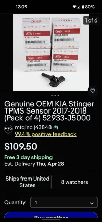

FYI I searched the part number on eBay and found several sets of OEM sensors for $100-$110 shipped from Korea if anyone else is looking for them.
I just had the 4 sensors from eBay installed on my 2022 GT. After about 5 miles of driving, they sync'd themselves and they're good to go now! I think I paid like $110 usd shipped or less.
Box of four $100 two days for delivery eBay
