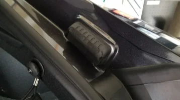

my foam has molden into overslam bumper shape, not sure how long it will stick.

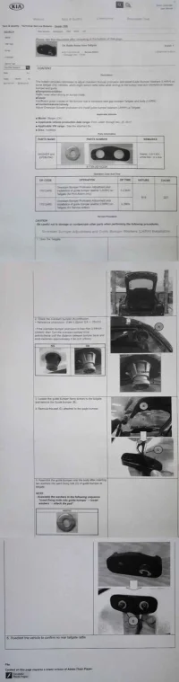

Hi, don't know if this has been issued before in the thread.. But kia has sent a service memo for the rattling noice.. There is a manufacture flaw that makes that noise and needs to be fixed by the dealer under warranty.. See document attached...sent it to my dealer and they are already looking for for the parts to fix it... Send it to yours!!
Yeah. That's the current recall TBS that simply doesn't work well. I'm assuming eventually they may retrofit our earlier cars with whatever setup the newer cars coming out of the factory have. Apparently they have no issues. Hook us up!

The foam trick as posted in this thread helps and since I've applied it a week ago, 100% rattle-free. With the right black foam, I don't mind it since it's fairly inconspicuous.
Happy with this "DIY" fix even if the foam wears out eventually and have to reapply it.

I fixed my rattle by adding two 1.5 mm thick rubbery pads I made myself between each of the hatch bumpers and the hatch.
Despite this success, I decided to have Kia service do their fix because of warranty concerns. The rattle was reduced but not eliminated by the dealer installation of the factory kit. I showed my pads to the Kia service guys and they installed one in addition to the factory spacer on each side. This has eliminated the rattle (so far).

i think the foam fix is begining to fail after week. seems liek the foam is compressing to the point the plastic bumber is poking through, i think i have to replace. hate to do this a weekly/monthly . . need kia to send out a letter and schedule a real fix.

Ok so I have the real fix...........
It looks the same as the first TSB but this is written in Australian...... Lol
You can thank me later...........
I can't understand the Australian. Does it say anything different? :p
