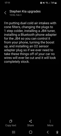

So I had a JB4 installed on my Kia Stinger GTS and after 4 months I am now getting low compression out of #5 cylinder. Took it to the shop that installed it and they stated they fixed it and as soon as I started it my car started shaking again. I took it straight to Kia and they did their diagnostics test on it and stated compression was bad. They did not want to cover under warranty due to the JB4 installed so they pushed the buck to the people that installed it. They went over all their installation and stated it was all installed correctly. I am now being told it is my responsibility of $15,500 for a new engine on a 2019 Kia Stinger GTS that has less than 20,000 miles on it. Does anyopne have any recommendations or who I should go to or am I pretty much with the luck I have and lose my car? See attached as to what they installed on my car.

I only ran map 1 & 2 and 3 1 time with ethanol but the guys that installed it did the mixture before I got the vehicle and I only ran that in my car that 1 time other than that just Superunleaded.. I attached what they did to my car on my message and here to you as well...

They said plugs one step colder. Do you know what brand? What gap?
Most people with JB4 recommend HKS plugs gapped no more than .024. Some use Denso, but have had problems. If they didn't use good plugs, perhaps that caused a failure?

I am not sure but my wifes car has the same set up as mine and hers did the exact same thing and so they replaced her plugs and so far with the JB4 and all on hers it is still running really smooth with no issues. I think that it is either the plugs or the 02 sensor adaptor they put on could also be messing with the system. So many things but I will try everything before I give up on this car... :) By the way here is what they said they installed: Spark Plugs NGK Laser Platinum
