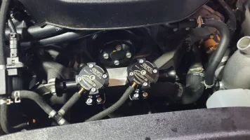

I have the Mach2's full vent to atmo.
With the trumpets. They are adjusted about a quarter turn looser then out of the box. They seem to work well in that configuration with minimal bleed off under low boost.
They really fit great and are a no Brainer.
looser meaning "less" - or "more" than out of the box. That isnt an exact science. My box will be diff . than yours. Do you have yours as more or less ? boostie sound
