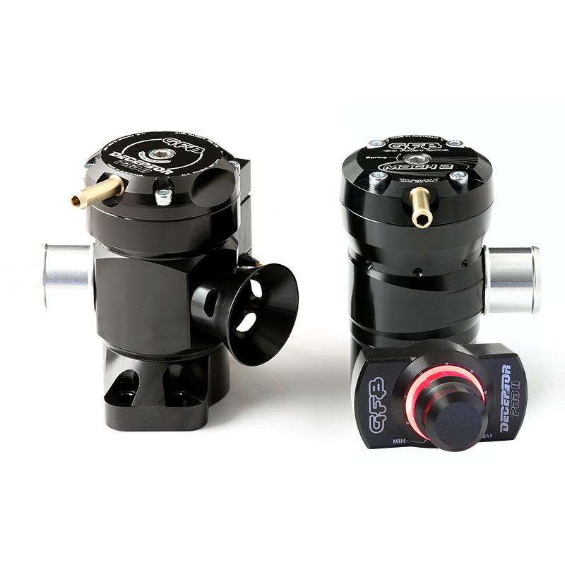

Does anyone recommend a certain brand for BOV?

I got GFB. Can either go vent or recirculate. Not to mention build quality. Metal vs plastic.

Does the GFB kits come with new hoses? piping or whatever... lol
