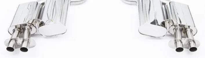

So would the best way to install this be wrapping it before installing the exhaust or removing the tips to install it after the exhaust is installed? I wonder how hard it will be to get the ends of the exhaust into the tips with the wrap on during install? I guess the tape is soft and looks like it compresses where it needs to since the tips are an oval shape correct?
I did it while the exhaust was already on the car, but I believe ascidiic suggested dropping the exhaust first to wrap it.
It maybe best to pull the tips out, then wrap the ends of the pipes/resonators and finally put the tips & piping into each other so it secures the wrap between the two. May take a little maneuvering of each piece to fit them together properly but in theory that makes sense.
Yes the wrap material is soft so I actually wrapped a separate 2.25” pipe to form the wrap to the width of the backside of the tip(yes oval but slightly more round from the backside). Then I pushed the wrap through the front of the tips until it fit over the pipes. That didn’t seal it completely, so on the other tip I just wrapped it directly on the pipe itself until it completely filled the backside of the tip and then secured it in place. That second attempt filled the tips better and was the best I could figure out while everything was attached.
Either way it works and was well worth the effort. I’m still shocked on how well it eliminates the drone and can’t thank ascidiic enough for the easy fix! :thumbup:

And yes I took the mufflers off before wrapping but if you're patient and nimble you can wrap them while they're on the car. You want to pack the exhaust tips tightly so there's no gap and push the muffler clamps up against the wrap snugly to hold it in place. Make sure the muffler clamps are on there tight because one of mine lost a nut last week. My 140 lb helper tightened that one I'm sure :whistle: so I replaced the muffler clamp nuts with locking nuts and hopefully won't be hearing the sound of vibrating metal from under the car again.
Based on what others are doing and it works I would say that's probably the exact reason for it.
The plates are just for aesthetics. If they were to cancel any drone they will need to be weighted/heavier
Partially disagree, The point is to stop the pressure waves from reflecting back into the muffler cavity. Those plates may not do the best job, but they will do more than having nothing there. There is a chance that the fiberglass wrap is performing double duty, both reflecting and absorbing the pressure wave and that is why it makes such a big difference. Remember that a lot of the resonator tubes are packed with fiberglass.
aesthetics would mean you could see them which you can't you don't even know they are there unless you are looking for them.
i wonder if to cancel drone this is why Thermal has the plates at the end of the exhaust tips.
Yes, creating a barrier to prevent reverberation from going back towards the cabin is why the stock exhaust has the plates too. That will stop a lot of the drone overall and the helmholtz resonators take care of the rest. The resonators only help at specific frequency ranges, but sure they are built specifically to our 1500-2500rpm problem area for drone.
