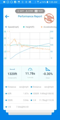

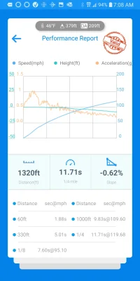

More testing done with stock mids back on. My LC is back and the car is running fast again. 11.78 this morning with stock mids vs 11.71 last week with ssr mid. Da 783 today vs 209 last week so the difference is .038 when corrected. 3 hundredths is run to run variation. I think this mod myth is busted on a tuned car.
