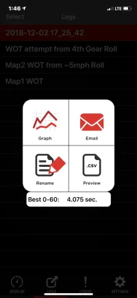

Just tested map2 (JB4) and reduced boost in 1st gear, and dropped .7 seconds back off my wheel spin for 4.07 0-60, and not the best launch, still spun on the shift.
Carrying 4 passengers, 15lbs of bacon and about 30 more pounds of miscellaneous crap, and 1/2 tank of gas...... not bad, not bad at all.

85B79947-C107-4B55-8D07-88F260ABDE5F.webp Just recorded on the JB4, which for 0-60 is probably pretty accurate. It’s only monitoring speed, not distance and time.

View attachment 16008 Just recorded on the JB4, which for 0-60 is probably pretty accurate. It’s only monitoring speed, not distance and time.
The JB4 performance monitor is as accurate as any other OBDII data based performance monitor. But not as accurate as high speed GPS based dragy. Good enough to give you an idea of what's going on but reality may vary. :)
I can verify the speed accuracy via radar. If the speedo is on, OBDII would be very comparable for speed, and speed only, I agree. It’s def good enough to be within 2 tenths of second on 0-60.
My app obd fusion was off by .4 though it was consistent run to run.
Gotta go dragy for 0-60. $10 off on amazon $139
