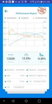

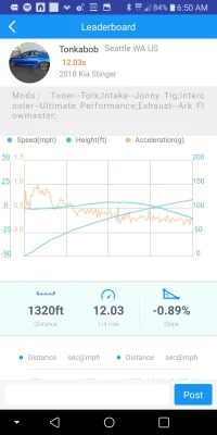

I mostly agree. But I believe you’re basing that statement on current 1/4m results, correct? As you know those numbers will keep changing and just depend on how many people with each tune provide results.RC kind of fast, jb4 fast and cheap, lap3 pro and ecu tunes really fast.
So I simply believe your grouping of these upgrades is misleading. The lap3 & jb4 are both hybrid style chips and are almost identical in tuning capabilities. Anything the lap3 can do the jb4 can do as well...
Not to mention Terry’s Stinger is making a lot more torque 531tq vs 505tq without DPs or any exhaust! The main reason lap3s producing more HP is because they are dangerously pushing over 23psi!
All I’m saying, is if you’re putting the lap3 at the top with tunes then I believe you must include the jb4 as well since they are basically the same chips.
