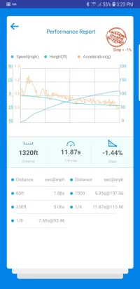

Reviewed the logs. Same thing as the last ones. JB4 maths out to a much longer time from 0-105. (13.6 corrected)
Timing is 10-15 in 1st. Ramping to 10 pounds of boost. IAT 70-73. Average everything. Launch is at 2300 rpms with 1.2 pounds of boost.
I seriously don't think the dragy is reading correctly. I think it calculates Gs based on time and distance traveled. Something is wrong either with the dragy or the connection to whatever it is reporting to. That's my opinion from the logs. You're faster everywhere on every setup.
I'd love for there to be ANY kind of indicator that would help others get faster. I just don't see one.
Just promise me you will post your drag slip no matter the result!
Dragy doesn't use the G reading for anything on timing. Timing calculation is done with the 10Mhz sampling of satellites using doppler shift. Meaning how fast you are moving towards or away from multiple satellites. You guys are really stretching to disprove this. Dragys are accurate. Period. This timing is as valid as anyone else's posted. He has a monster front half, as good as anyone else's. Not sure what the need for the CSI shit is.
I understand the first part. I am saying it uses distance traveled and time calculations to get the Gs. It does not have a built in accelerometer. I originally thought the Gs would disprove any theory that the dragy was at fault, but researched and every source I could find said it didn't have an accelerometer, so those numbers are based off of the same thing everything else is.
I'm not stretching anything. I already did the math in my previous post in the 1/4 mile thread, and this has the same issue. JB4 is not meshing with Dragy... I asked for anyone else that had JB4s to throw some logs out so we could see if that indicates anything, and got no takers. Mine match perfectly. I don't want to be a drag, so I'll just not comment on this anymore. I figured some people would be interested!

Non valid 11.87, 11.95, 11.96 and a valid 12.05
all on map7. It's not going into limp mode. Thought maybe it was at first. But at exactly 115 I lose power and then it comes back. Dont think it effects et at that point of the run.
After looking at the logs 11.87 was map 5.**
