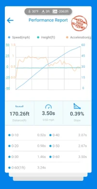

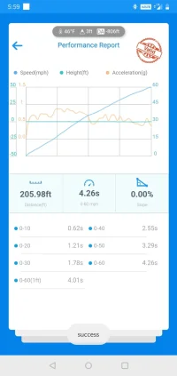

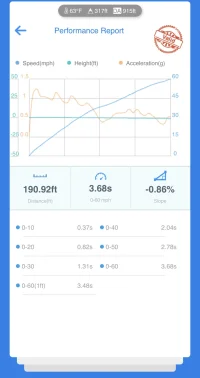

Just got my Dragy a couple days ago. Finally got a run when it wasn't wet....
G70 AWD. Intake, midpipes, exhaust, VT Snorkels, Dual CC. JB4 Map 1.5 (custom Map 6, pretty mild), OEM spark plugs. Also had a passenger with me.

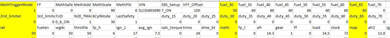

Great DA today. No snip, i did surgery to reversed that yesterday. No jb4 boost or IAT spoof. Did find that Map 0 sprays WMI sometimes but not always. (with WMI trigger =1)

Nice run and DA! Let's see the log. Map0 sprays meth if meth trigger = 1 to spray meth on all maps and you are logging the runs to enable CANbus.
It didn't today. I always leave meth trigger = 1.
I was going to test map 0 for a few runs and then go Map 6 with some IAT spoof, already set to 30

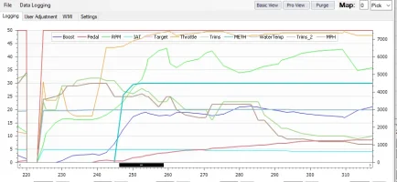

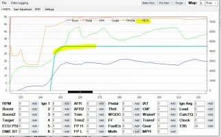

First run Map 0, no meth.

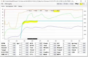

Second run Map 0, meth.
second run map 0 - meth
The last run I did change to Map 6 and can see that IAT change, but the map as logged stayed 0.
Sorry don't want to give out full logs right now as Tork is in the final weeks of Stage 2 and don't want to steal his thunder.

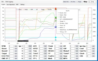

Hmm should be running on both assuming settings are the same. Was water temp > 160? Throw IAT and fuel trims on both we should be able to tell from that whether meth was actually flowing on the first run to rule out an app issue.
IAT on this run was 46 and the next run with WMI was 48
Water 212
Is there a min IAT?
No min IAT. Trims dramatically different between run1 and run2?
There is also a min road speed check. Is speed logging properly in the non-meth run?
When the meth should turn on the no meth run its 34 trim, 6 mph and 6-11 psi
the next map 0 good wmi pull at that same spot is 31 trim and 6 mph 7-12 PSI.
3rd run (map0) and 4th (map 6) runs ,with WMI, had 29 and 34 trims at that same spot
Should be a lot more variance on fuel trims under meth flow, at least 15 difference at full flow. I guess once you can share the logs we'll try to sort it out. Until then you can always set meth trigger back to 0 so meth doesn't flow on map0. Better than not knowing whether it's going to flow or not.
