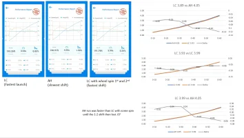

These are 3 of my runs from yesterday. 3.93 was LC, 3.99 was LC and wheelspin in 1 and 2 (damp road), 4.05 was AH (Auto hold).
Interesting to see how the initial launch and the 1-2 shift impact the times. Car shifts at 37 MPH. Gray line is the difference between the two runs at each data point.

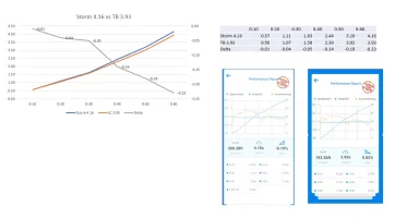

And one more comparing my 3.93 run to @Stormlasher 4.16. Pretty level up to 30 MPH. Storm should be heading for a sub 4 second run, then the 1-2 shift and loses ground, almost .1

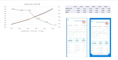

Same here. Storm is ahead by .05 @ 20 and 30 MPH, heading for another sub 4 second run. 1-2 Shift and loses .12 seconds.
Roll racers hate to face that shifting speed / power matters in 0-60 and 1/4 miles. 4 shifts in a quarter mile and this explains the .3 to .4 ECU tune advantage over box cars. Yeah I've said this many times and everyone resists but the G map and time stamps of the 0-60 do illustrate this nicely.

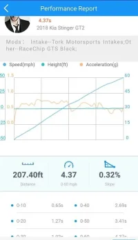

@ryan1stinger in at #7 with his RWD, RaceChip and Tork Intakes. Giving @CFLGT2AWDSting the boot

7. 4.37 seconds, 207.40 feet, +.32% slope @ryan1stinger
RWD, RaceChip, and Tork Intake

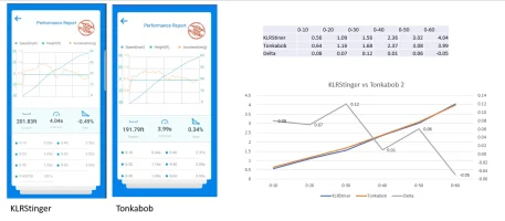

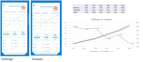

Here is one more. This one is even better. @KLRStinger is probably the highest HP AWD stinger (FBO). Looking at the gray delta line on the excel graph, I get initial jump then we stay almost even at 10,20,30 MPH. On the 30-40 MPH / 1-2 Shift i gain a whopping .13 seconds. His HP kicks in early 2nd gear and he takes back .05 but gives back .11 50-60 as he cuts power earlier for the 2-3 shift. You can also see this same story in the orange G graph on the dragys.
And one more for those that want to claim "dig" and "momentum". This one KLR has the jump and a .12 and growing lead at 30 MPH. At the 1-2 shift he loses .11, hits power in 2nd gear and takes back .05 and heading into the 2-3 shift gives up .09. KLR had a sizeable lead and gave it up in 2 shifts.
