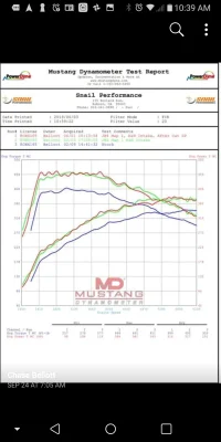

Here is another dyno from fb showing the secondary dp does just a little tq way down low and no net hp gains. Since the original dyno posted here had some question marks.
FB is lap3 usa.
Can’t read the numbers, little blurry... good info though. Can u list the gains over stock at the low end?
Its not my chart but here is the original. Still hard to read. Chase Bellott
Looks like power under the HP curve is the same or slightly less with the secondary.
I did say I felt the tq:) if I’m reading that correctly that is just over 30lbs more in tq at lower rpm and tq stays consistently higher.
I'm reading it as 15 Tq (maybe 20) between 2400 and 2800 RPM. At full throttle you are never in that RPM range except from a dead stop for a fraction of a second. There is a 15-20 Tq loss between 4800 and 5200 RPM which is hit in every gear. Hoping that part is a run to run fluke.
Not until 5800 rpm does tq drop, not 4800.
My take after looking at it in more detail as that the slight rise at start and decrease at end create a wash. But for the majority of current u are pulling 18-28(30) more lbs of tq

Early on it looked like there was some potential gain in the low-end and maybe response (faster turbo spool). The graph, however, looked completely wrong and did not make any sense to me. HP was indicated as decreasing, the TQ numbers were indicated as increasing. An abnormal spike at the end (maybe gear shift? or skip?) And the numbers didn't cross at 5252 (EE youtube video explaining why this occurs) where I would expect it. If it didn't correctly cross there I'm going question the accuracy of the run. So I personally ignored this result.
Then lots of people using their butt dyno again reporting they feel this additional low-end torque and response. Some of it might have to do with sound output, which I will talk about in a bit. But primarily I think, the placebo effect is strong often when money is involved because people want to feel justified in their purchases. I'm also very suspect of this when I buy things. However, for big purchases, I try to do as much research to avoid unnecessary spending on something that doesn't give me the desired effect.
Recently, looking at the last graph from the FB user, comparing intakes+JB4 to intakes+DP+JB4 it looks like it's within margin of error for the run. Meaning no low-end torque gain or top-end HP gain. Because the graph is clean and it lines up with @Tonkabob 's findings, I'm concluding the secondary DPs don't do anything except for increase sound output - which could cause a false sense of feeling faster. This is why manufacturers have gone and put in fake or enhanced engine noises using the speakers or other methods. It makes the driver and passengers feel the car is faster.

lol u both are right, I was reading the graph wrong:) based on that dyno now that I’m reading it correctly, 480-500+ would be better spent elsewhere. I like mine but I am no longer confused:)
Ok... that last dyno gives a good look(now that I’m not misreading it) ha!
