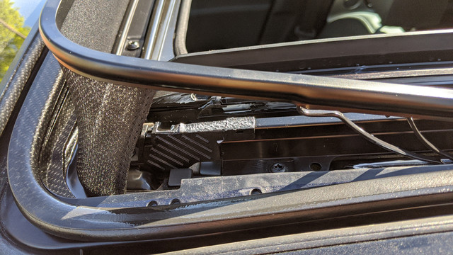

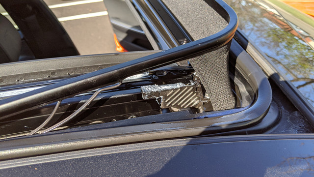

My car before the fix:
Well I'll be god damned, this fix actually works! It's not about filling the gap, it's about "blunting" the nature of the contact. I used aqua tape (which is basically thicker electrical tape with a more serious bonding adhesive) and put Shin-etsu grease on top to ensure that if the foot ever drags, it can't catch the tape and take it where it doesn't belong:
This reduced my sunroof noises by about 80%! There are still some other creaks and occasional noises, but this definitely made a difference on mine. You can see from the grease that it doesn't actually touch most of the time (I dabbed the grease on it to ensure I could tell if the foot actually slides along in the "well" that just got filled in, and it clearly doesn't), it's that when it does it's a tappity tap tap noise.
Now to deal with the continued door ticks (both fronts, Shin-etsu grease only stops it for a few weeks at a time), 3rd brake light vibration (my exhaust and certain road surfaces cause the right amount of vibration and my 3rd brake light vibrates enough to make that annoying plastic vibration sound; I can replicate it by gently tapping on the assembly with the bottom of my fist), and center console ticks. Man, I miss my '18 GT, it had one tick in the driver's side door, and that was it :cry:
