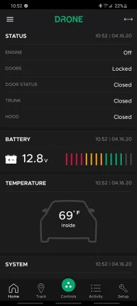

I got the Compustar w/ Drone kit installed and here in Florida having remote start is a necessity for me (no garage at the moment).
The kit is awesome with no issues for 6 months. The Drone module allows a phone to used as a remote and give many other cool features like GPS tracking and vehicle statistics. I also wanted the fancy remote with the screen so I got the T12 and love it so much. Start the vehicle locked, use any remote or button to unlock, press brake pedal and go.
I got the kit installed for a great price (employee discount) but the T12 remote was pricey. The Drone 3yr subscription wasn't cheap either but I feel is worth it you daily drive the vehicle. Overall highly recommend the kit!
20200819_111738.webp20200819_113312.webpScreenshot_20200416-105259_Drone Mobile.webp
