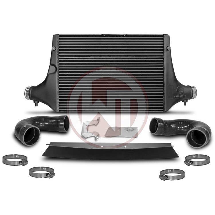

To me, this is the intercooler to get:
Goto 'DESCRIPTION', and look at the temperature graph - the charge is barely above ambient!
With this installed, and at full throttle, your engine will think it is sitting on the beach at the ocean, ...under an umbrella, ...a drink in hand, and a very cool persistent breeze blowing in from the water...
That is what an intercooler is supposed to do - and in this case, bigger is certainly better, and not an item where to try and 'save weight' due to thermal mass considerations. Thermal mass is GOOD - just like it is with brake rotors.

I heard that some people that installed that IC had increased turbo lag issues.
I am eyeing IMRAmerica. 600hp core 21pnds
I'm still waiting on Mishimoto to fill a back order for me. ETA is 1st week of May for Mishimoto IC, but this is $300 cheaper and a 30 min drive away. No shipping :oops:. I'd have to wait an extra 2-4 weeks and I've never been all that patient. Anyone have any comparison data on the cooling between IMR and the Mishi offerings or opinions? Thanks
Certainly, the increased volume may cause some more lag. Whether that is a problem or not depends on the application.
For straight line drag race applications, probably no effect. For applications where significant changes in throttle are required, then it might come into play. Using sport mode, which keeps higher RPM's thus the turbo's spooled up more will help.
