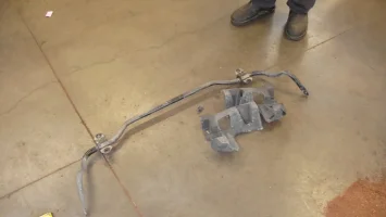

Utter bollocks. "My" dealer installed both of my Eibach sway bars no questions asked. Cost was for c. half an hour labor front and c. one hour labor rear.

^^^Hour and a half, truly.

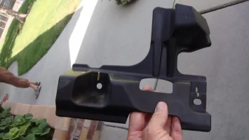

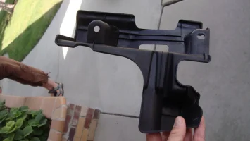

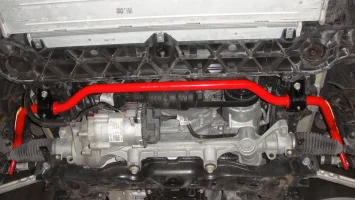

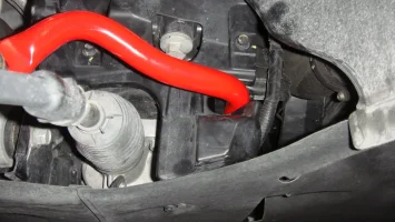

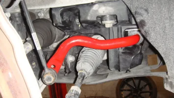

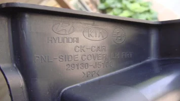

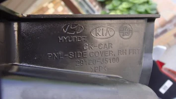

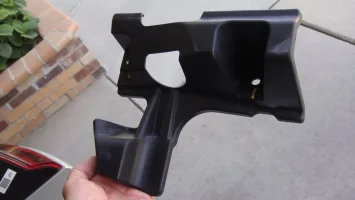

(edit: Well, actual time was somewhat longer on the front, but they only charged half an hour: the reason was because they removed those plastic deflectors, said they were "rubbing": At first I said, "Go ahead and toss them, if that's the case." :oops: :rolleyes: :unsure: o_O But then I changed my mind as I was about to leave and had them retrieved from the trash. Slept on it, then returned in the morning and had them put them back on.:thumbup:)
DSC09368.JPGDSC09369.JPGDSC09371.JPGDSC09372.JPGDSC09373.JPGDSC09374.JPGDSC09375.JPGDSC09376.JPGDSC09377.JPGDSC09378.JPG

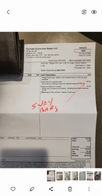

Just had BOTH Whiteline sway bars done this morning after a long backorder- especially the front. Here's a copy of my bill, my guy ROCKS!
Everytime I get my car back from this guy, I fall in love all over again...
Basically, like most here says- 1.5hrs to install.

endlinks? or front and rear sways installed for $160? If they did the front and rear sways for $160 that's unbelievable.
$160 for both front and rear with endlinks? I was quoted 6-7hr labor time
Endlinks were already installed by the same shop a couple months ago, as they shipped right away and were part of the sway bar package. They were installed the same time as the ATQ subframe bushings actually. I don't know why he included the links in the description of the work performed. I dropped the car off last night after they were closed and received a text at 9:30AM saying the car was ready, I doubt he arrived eRlier than 7:30 on a Saturday morning- you can see he balanced/rotated the wheels too, so 2 hrs total seems accurate. I asked him how did the left side, rear go? He stated that he dropped the subframe an inch to gain the clearance needed...just straight time, fck that 6+hr book time sh!t. I do have 4 cars that he maintains for me. Just an honest mechanic, who knows what the heck he's doing. This guy was a top Subaru guy in the country and was doing doing warranty work for Subaru for a few years after opening his own shop, until a Subaru dealership complained.
