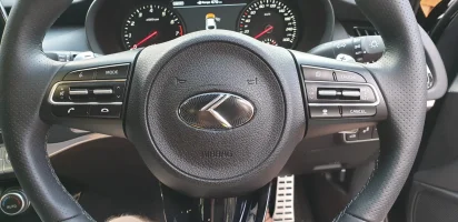

Good info on the thread - here's mine

Adding pictures.. You can see where I grabbed it from the right side.. I'm sure there is a way to take it off and potentially re-use it, but I did not plan on re-using it, so my concern was protecting the car not the badge.
View attachment 22669 View attachment 22670
Top picture you can see where I cut the center slit and pried up. Bottom photo is new badge installed.

Here is what the Kia badge looks like after it is removed. You can see the metal prongs. It’s really maleable tin like material.
Also some photos of the new badge. Pretty happy with how this went. The new badge could be 1mm or 2 wider as it leaves a small gap on the upper corners that my OCD notices.
I will keep it this way for now but keep looking for a nice cost effective alternative. I like the Stinger badge above but with shipping and US currency exchange it’s too rich for me.
I see in your pics that you now have a slight crease above the emblem from prying off the old one. I changed mine this weekend and the same thing happened. I was annoyed, but I guess I have to live with that imperfection.
Also, the overlay is not shaped exactly the same (as far as the concave nature of the back) as the surface of the steer wheel behind the old badge. So as a result, my emblem got pressed on not completely flush (as it doesn't hug the underlying shape of the wheel perfectly). So the lower side is more flush to the edge than the upper side. I'm not happy about that. But again, I chose to do this, so I guess I have to live with it now. Unless I decide to one day remove the new emblem, and reinstall another and take more care to get it as perfect a fit as possible.
