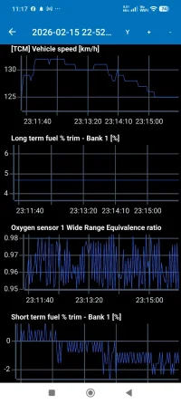

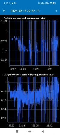

Please check the images attached below. I took these readings when I was holding constant accelerator pedal to maintain speed on the highway. The thing is that the O2 readings were the same on the other Stinger that I drove, the one without the fuel economy issue. I never see it going over the value of 1 when driving, it always burns a little bit rich.
From my research I concluded that the O2 reports just that, the remaining oxygen that's getting out of the cylinder, not the amount of unburned fuel. So maybe there is a problem with the injectors or HPFP that give the car more fuel, but not more air (as per the A/F ECU map), so not all fuel is getting burned.
Well maybe that's normal...I was thinking those were just lambda values but we're a bit past my level of knowledge.
