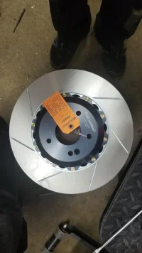

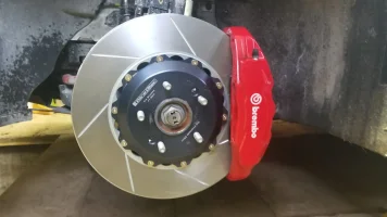

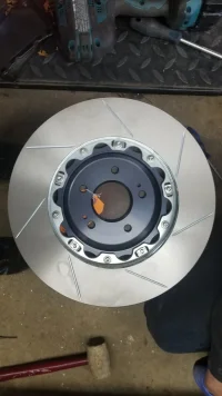

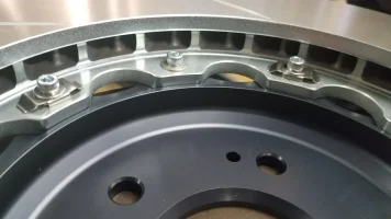

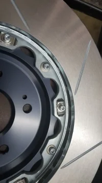

Installed the Girodisc rotors and magic pads today. Dead simple install, took less than an hour for both sides. Beautifully made, full floating with anti rattle HW from hat to disc. Great quality and amazing price Girodisc. I paid more than twice this price for basically the exact same thing on my CLS 63. Hit up Nicholas at KHARZ for the hook up! Anyhow, on to install
Steps for rotors:
Remove wheel,
Remove two 17mm caliper retaining bolts from rear of spindle
Remove caliper
Remove OEM rotor phillips retaining screws
Remove OEM rotor.
Install new rotor per included instructions noting left and right orientation.
Install caliper again
Steps for pads:
Use a punch and hammer to knock back alignment pins
Remove retaining spring
Pull out OEM pads
Install new pads in reverse
Note. New pads do not have dampening weights on them like the OEM.
Impressions: after taking the car out on my favorite stretch, I was able to bed them in following the included Girodisc instructions. The dreaded brake wobble (aka warp) from the OEM pad and rotor combo 100% gone. Pedal application is smooth at all speeds. Initial bite seems softer, but during bedding in felt consistent and fade free. It was also -5c so not ideal conditions to test braking. I'll report back on dust and performance over some additional time and temps.

Do the scallops in the rotor engage into the brake hub somehow or does all of the braking load from the rotor get transferred into the hub by those 10 tiny screws?
Transfers to the screws just like every other 2pc rotor does.
