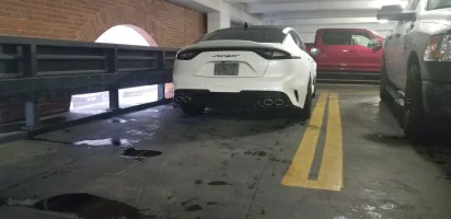

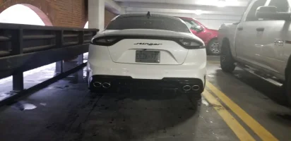

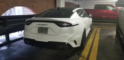

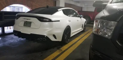

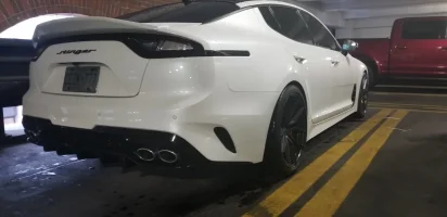

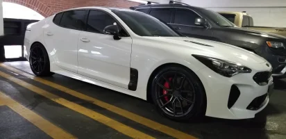

Couple of quick booty pics. I'll get some outdoor glamour shots when the weather clears up
