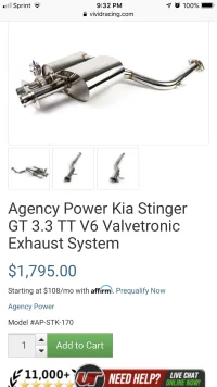

3.3TT Exhaust Comparison Chart
Yeah considering this exhaust too but need more reviews from people out there
There are quite a few. I am also thinking of buying that exhaust.
