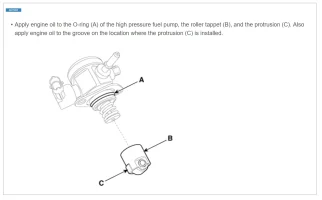

It’s high pressure fuel pump. It is ran off of a lobe on cam shaft . So of course when u rev it up it will be faster tick. Use pure synthetic and sea foam valve and turbo cleaner 2 times a year .
It’s high pressure fuel pump. It runs off lobe on camshaft. So when u rev it . It goes faster. Also with these you will get fuel injector tick. I know on mine sometimes injectors will stick and be a lot lounder . I use valve turbo cleaner twice a year. Full synthetic oil . Bought my gt nov 2017 one of first 500 owned. All the high pressure gas stuff on this engine is just loud. I have 30000 miles all the mods u can think of. Car still runs like the day I bought it just much faster now lol
^^I thought these cars used electric fuel pumps, not mechanical??
I don't think that is unusual on GDI engines. I know the Ecoboost F150 uses a mechanical HPFP.
Thank you for the reply FI stingergt. The unusual part of this noise is that it is coming further forward in the engine bay, away from the fuel pump, and sounds right at the top of the engine. The cold starts have become very rough since the loud tick started and causes my car to bang and shake at random times during cold starts. I also installed an oil catch can very early when I first bought the car so the valves should be pretty clean. I really don't mind the loud valve and fuel pump/injector noises, but I can feel the car isn't running quite as it used to before the louder tick started, cuaisng me to think I have a more serious issue. If you don't mind me asking, what valve cleaner do you use? I'm glad to hear your Stinger is running like a champ still with all the mods!
unplug the fuel pump , the electrical connector, then cold start it , then plug it in as its running , thats what i needed to do to convince me it was that , not lifter tick or rod knock
The dealer did the same to for me, except they cold started it AND THEN unplugged the pump (and the noise immediately stopped).

the pump is just loud until it builds oil pressure to cushion the blow of the solid tappet , is my guess , its strange but a real thing .

in my experience, hearing different cars with dfi, the ticking is loud all the time, on cold start it is louder than normal but even after warm up hpfp tick is noticeable especially if idling next to a building or drivethrough. Lexus being lexus listened to peoples complaints and updated the sound insulation around the hpfp and under the hood to mitigate it a little...
byebyeSTI, does your 3.3T continue to make the louder ticking noise after the car has well warmed up and been driven for awhile as well? The ticking noise never goes away or gets quieter for me. When I get to work an hour later, I can hear the noise audibly off the concrete walls in the parking deck, especially when I accelerate from a stop. I'm hoping to give a shot at disconnecting the pump this weekend to narrow down the issue...hoping it's just as you guys are thinking. Thanks again for the help and replies.
mine makes the tick . fuel pump noise only on cold start , for id say 20-30 seconds longer if its colder , there is a low level injector tick after that that is barley audible when opening the hood . to test the pump noise , cold start the car with hood open , get out and unplug the injector pump quickly if thats the noise you are worried about it should stop until you plug it back in , do it quick to avoid a cel . or the car shutting off , also check the oil ?
