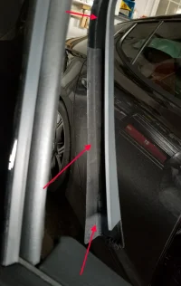

If you hear a small ticking by your ear as you drive, it can be due to a combination of one or all of the three sources:
1. The slight motion of the door frame's plastic trim hitting against the door's metal frame beneath it. This is because the trim is not tightly assembled on the door's frame and its plastic moving on metal makes the ticking.
2. Part of the sound is also from the motion against the rubber door seal - plastic moving on rubber.
3. The slight motion of the entire door over irregular roads thanks to the door latch not being as tight as it should. You can tell if your door is "loose" by lightly placing your fingers in between the plastic trim and rubber at the top portion of the frame. You will feel the door moving up/down if you have this issue.
This DIY is to address points 1 + 2, the plastic trim and rubber, to eliminate the majority of the ticking. The latch tightening should be addressed by the dealer, although at the time of this writing, I have not yet pursued this.
Here is the trim in question, shown for the passenger door. (All steps equally apply for the driver's door)
Fully roll down the window. Carefully insert a prying tool with light to moderate force to snap away the trim from the frame.
Pry along the entire trim, and lift up the bottom section to free it .
Apply felt tape along the inside, in particular over protrusions (contact points)
Apply felt tape along the metal door frame lip beneath the rubber
Snap the trim back on. It will feel tight.
Apply a silicone spray along the rubber seals found on the door frame and the car's frame (not shown).
DONE!

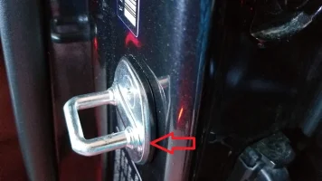

UPDATE. After two visits to the dealer, they weren't able to tighten the driver's door/latch so I did it myself. Although not 100% eliminated, it has reduced the ticking further and I'm OK with it now. The idea is to readjust the latch in so that the door is pulled in a touch more to make a tighter lock against the car's frame. The tighter lock will reduce the minute vertical motions of the door while driving which is the fundamental root cause of the annoying door ticking/squeaking.
I added a slim piece of metal about 2mm thick on one side in between the latch and rubber seal and away from the srew holes so as to not interfere with reassembly and latch strength.
I used a #40 Torx bit to remove and reassemble. Here's a pic after installation. You'll see the latch now protrudes where the arrow is and is flush on the opposite side to create that slight bend inward. I have no concerns with this setup running it over a month now and latch is very tight.
