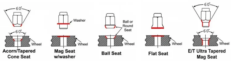

OEMs are silver mags with a washer. The acorns are for your Fast rims. Same setup here but my acorns are black and I've done every switchover myself.Speaking of OEM Lug Nuts I have a Question. Had 2 different types, one set for the original 2019 Special Edition (Canadian), another set for a set of Fast "Switch" for Winter. I can't for the life of me remember which was which. The first few wheel change overs I went to dealer, they seem to use the same ones all the time and they put all lug nuts in a pouch. The 2 sets are Acorn/Tampered Cone Seat & Mag Seat with Washer.

Thanks a lot D.J.....My OEM Kia Wheels (2018) - are definitely acorn/taper style. I know Kia switched to mag style at some point, for some reason.
Those mag seat with washer style would "work" on my 2018 taper style wheels, but the "shank" would not fit inside the taper.
I would say, they would work in an emergency, but they are not correct for my wheels.
If your wheels are designed to work with mag seat style lug nuts, they would not work correctly with 60° tapered lug nuts.

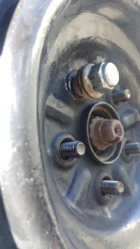

View attachment 86040View attachment 86041View attachment 86042
I have seen mag style lugs used on taper style wheels (specifically steel wheels). It technically "works" but looks kinda stupid. - not my pictures .
