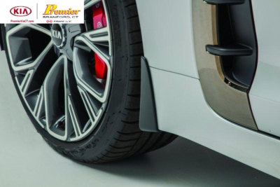

My '22 stinger didn't come with mudflaps from the dealer. Can I buy 2021 OEM Mud flaps and install them?
This is what I recently fitted to my '22. That was the best price I could find.
I suggest doing the brake vent mesh at the same time so you don't have to pull the liner out twice.
Yes it will fit.
There's no need to touch liner when fitting guards.
Would recommend the rokblokz mud guards. Much better coverage. Also work really well, big difference between driving in the wet with vs. without. Got to see the results of both.
100%. I replaced the OEM ones with rokblokz "regular" (not the "slim"). Significantly more functional, and I think they add some nice visual weight down low. I think the operative term these days is thicc. I also chose to use them to add another layer of side vent mesh, since the rokblokz have cutouts to match the factory wheel well liner.
I also agree with purchasing the rokblokz, although I opted for the slims, and they are exactly what i was looking for. Enough poke to keep the paint safe and cleaner but not giving off the rally mud flap vibe. :) They did fit my 2022 and you do have to pull the liner back a little bit but it goes right back into place.
Do you end up bending the liner doing it that way? It's just a few easily removable clips holding it in place.
No. Use existing hardware of one self tapper and plastic plug on front and 2 x self tapper and 1 plug on rear.
