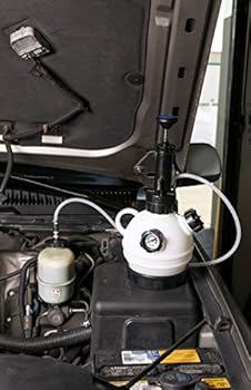

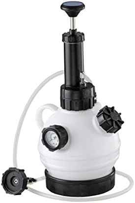

Did search for a bit and didn't really come up with anything. Has anybody actually changed their brake fluid themselves? If so, did you use a pump/kit like this:
YSTOOL Manual Brake Clutch Fluid Bleeder Kit Oil Change Bleeding Tool​
The one Issue is the master reservoir cap seems to fit every make of car except Kia. I think our break fluid reservoir cap is larger than 45mm, plus it's not a threaded neck on the reservoir tank.
Thoughts and suggestions on process?
Combo below from amazon worked
Needed to buy an adapter
ARES 18002-50.7mm Master Cylinder Adapter - Use with Most Imported and Some Domestic Vehicles - Use with Brake Fluid Bleeders​
ARES 70921-2-Liter Manual Brake Fluid Pressure Bleeder - Makes Brake Fluid Changes Quick and Easy - Easy One Person Manual Pump Operation​

I thought the motive power bleeder with the 0107 cap fit the stinger?
so, I went with the old fashioned way, some 1/4 inch hose, an empty water bottle, and my son pumping the brakes. Worked great, just took some time to get everything prepared. I bet I could do it in 2 hours now that I know what I'm doing and that's including getting the 4 wheels off and the car up on jack stands, and then all back together. Went with Motul RBF 660. Ready for the track with that and my G-Loc R10 pads.
Looks like it does. I'm not 100% certain though.

^^The motive power bleeder really does make it a one man (how many women you know that bleed their own brakes.....) job. Just pump up to ~15 psi then loosen the nipples. Fluid comes out. Stop when clear fluid is visible.
If you can jack the car up and get the wheels off, that's half the battle.
Good point. May be cheaper to get the bleeder and just do it myself.
Do you know which model fits the stinger?
