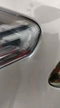

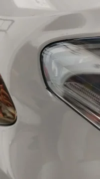

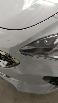

0713181956a.webp 0713181956a.webp 0713181956a.webp 0713181956b.webp 0713181956c.webp Well, I'm in the club. During inspection of my headlight area found a small chip in the driver's side, and the passenger side looks like it's about to do the same thing. I had paint come up during my rebadging as well. I guess it's a trip to the dealership for me tomorrow.

So I went to the dealership tonight to look at a Panthera Metal GT (really cool color; almost black from afar and when you get closer and the light reflects, more grey). I randomly looked at 4 Stingers (dealer had 14 on the lot!) to look for the paint issues folks here have talked about where the paint is coming off where the headlights touch the front bumper. 2 of the Stingers were 2.0L and 2 were 3.3L. One Blue, Red, White and Silver. 3 of the 4 Stingers had paint coming off the bumper! I was very surprised. It wasn't a huge area and I'm assuming the front bumper is plastic so it wouldn't rust, but still, this is a major issue to have this long after initial launch.
