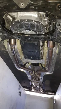

Did my custom mid pipe with h crossover on the Jun BL back to Magnaflow x muffler then to dual varex mufflers. The new mid pipe 100 % solved the rattle/rasp. Sounds amazing now, just as I'd hoped. No need to add cats back now

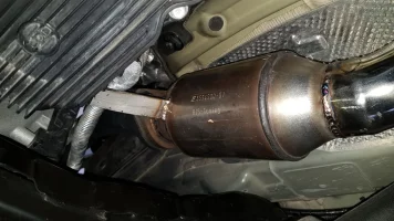

Small update, should be ready today. Hopefully it reduces the rasp to the extent I don't need a resonator. The cat is 200cell and 4.25" dia.

Finally the car sounds nice and drivable. I would say 90% of the rasp is gone with the HFCs. No noticable power loss, infact i ran faster on Map 2 then I ever did before.
Also for anybody thinking of installing catless primaries, I installed HJS catted adapters for the O2 sensor, you can see the cat inside the fitting. you will need the 45degree ones part #999190. I have yet to get the CEL and I have put atleast 1k miles on them.

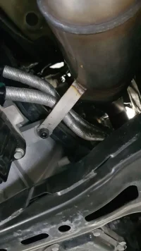

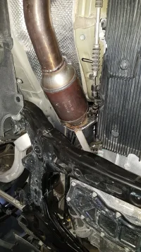

I didnt see the need to relocate the sensors since i didnt get the CEL with the catted adapters. So both sensors are before the HFC in their original location on the NGT primaries, pics attached.

Oh I get it now. Nice job, good to know the catted adapter work good to prevent the CEL light.

Its running great, nice sound when valve is closed, really loud when valve is open.
Anything in particular you want to know?
Performance wise are you satisfied? How is the drone with valve closed and open?
After adding the cat, no drone with the valves closed. Valves open its really loud with drone at the lower RPMs. I spend 98% of the time with the valve closed.
The HJS cats made a huge difference in the sound, makes it sound slightly more exotic.
Performance very satisfied.
