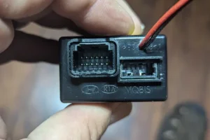

With it taken apart go ahead and drill a small hole above the raido side of the "usb" port. Here is a pic (pic shows board inside, obviously dont drill while the board is inside).

At this point it should look like this:
