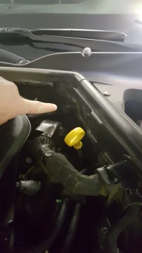

I did this today. Easiest way on any car is usually your brake booster. On our cars, there is a vacuum line coming out of the driver side plastic area at the rear upper engine bay. Press and slide the clamp and slide the hose off of the connector. When you check for a vacuum line, always put a finger on it when the car is running. You'll feel the suction. Spray it in there. It's going into the intake manifold. A LOT easier than removing hose clamps on the throttle body.
Any chance you can get a picture of this vacuum line please? Thank you
One other suggestion: Warm your engine up then turn it off before removing that vacuum line. It's harder to pull off with it trying to suction to the connector.

So, did the vacuum line work , in the pic that StevenTman posted?
This is the vacuum line that I used...
