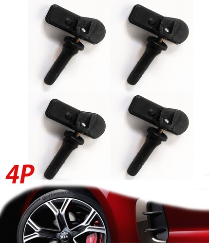

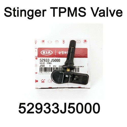

OEM sensors can be gotten for less than $100 for set of 4 and require no programming or resetting OBD2 fault codes. I've bought 3 sets off ebay shipped directly from Korea. The sensors on my '19 Stinger OEM wheels are showing TPMS fault. I'm not driving on them right now but my car is still under warranty. I really don't feel like having to swap those wheels back on and making an appt with the dealer and wasting at least a few days just to get the TPMS sensors changed out for free. For less than $100, I'm probably gonna just buy the OEM sensors again and replace them myself.
Here are a couple of ebay sellers I've bought from:
