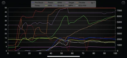

Base stock map 0 and fbo besides cat back map7. No done yet
FBO as in intercooler, intake, down-pipe, and mid-pipe?
Yes. Stock cat back after the secondaries. Trying to keep it quiet lol. We’ll race with out exhaust. Hopefully weather holds.

Spinning on the rollers lol. Is dragy and track time. It only hooked in 5th gear lol
Trying to upload the Dyno run but I guess is too big of a file
No cell. JB4 had nothing to do with it. It has hfc and spacers on the secondary sensors
