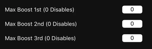

Last question @Terry@BMS how do we use the gear selection boost limiter on the jb4, i think this well our times improve especially for those of us w the rwd
No problems changing maps on the fly as much as you want.
You can evaluate map2 with the fuel wires on, but E85 is the way to go for sure. Use 5-6 gallons E85, rest 91.
On our car on boost by gear I run 2psi in 1st, nothing in 2nd and 3rd.

What maps or whats the most potent mapni can use while running e85? And im gonna change my boost by gear setting for 1st gear also, thanks for the quick reply
1EFE36D3-263D-4007-928D-364BC4B7875B.webp @Terry@BMS, are you referring to this section for the boost by gear adjustments?
