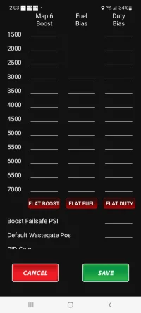

Hi, Can someone help point where I can find the Boost Fail Safe setting on Jb4 app ? Cheers
