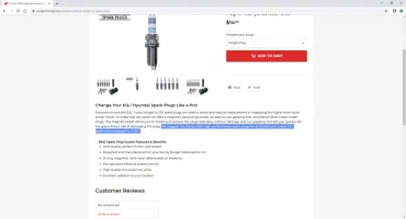

Yes you may be okay, but why choose to increase your chances of misfires and have lower performance?

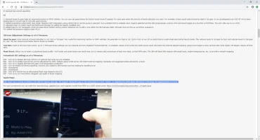

There are multiple reasons Terry/BMS states to gap the Denso’s at 0.022 and not higher. He’s testing different gaps and found optimum performance is at 0.022. Also the lower the gap the easier for the coils to produce an effective spark while under higher amounts of boost. So more potential performance and less wear & tear on the ignition system are just two advantages from using the proper recommended gaps.
And I do agree the stock 0.034-36 stock gaps were a big problem, but I do know of multiple people that had misfires even at 0.022-0.025 and dropped to 0.020 for smoother performance especially at higher boost levels.
So unless you have a legitimate reason and/or more experience than the creator of the JB4 I’d think it’s only logical to follow his recommendations instead of experimenting and increasing your chance of issues & less performance.:thumbup:

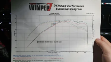

Got on a dyno to see what numbers I get.
I had "only" 439ps last spring with JB4 and WMI on my otherwise stock car but my settings were far from optimal.
Same dyno, 6 months later
-> Best run : 494ps 70kg.m (= 487hp 504lb.ft)
Map8, 83% ethanol, BM7 nozzle (700cc).
They turned off my car and the bluetooth connection expired so I don't have logs of the 4 pulls (feeling so stupid..).
I still have the stock exhaust on, so I hope to break 500 next spring after I make improvements. :)
FYI, AFR does not exceed 11.7 and no TDC fooling.
Very nice and impressive results, especially with stock catback exhaust.:thumbup:Looks like the primary DPs definitely add about 20-30whp and you’re basically matching the stock turbo record right now. With a high flow catback and the right DA you may just break the record and hit the 500whp mark!:D
Curious what your “boost additive” & “signal scaling” settings were for that run?
Peak numbers look good! bummer on the logs, if for nothing else to see if it has any more power in it.
I am really curious about the drop at 6.2K RPM.
But without a log, it will forever remain a mistery...
