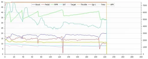

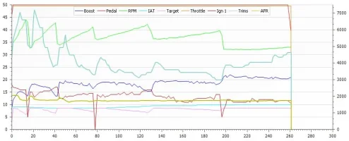

We have one of our compact OCCs installed on the boost side (driver side) and after tons of pulls caught only a drop. Need to canvas a wider range of cars but it might be the driver side isn't beneficial enough to justify the cost and all you need is our vacuum side kit.
With WMI the IAT readings can get convoluted. Which log is the new IC and which is the factory? Is the lower IAT the new IC? If so it's a dramatic difference!
View attachment 26585 View attachment 26586
