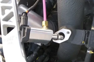

Need some advise with those that have installed the WMI kit. I just want to be sure I am doing it correctly.
1. For the below picture. Do I just push the hose into the elbow?
2. Do Just push the elbow fitting into the pump?
3. Does the fitting with the O-ring in the correct position? Or should it be flipped around?
4. The direction the arrow is pointing means the direction of the flow? Meaning the arrow should point towards the bms nozzle?

You push in the push/lock fittings. Move oring to other side of WMI nozzle, the small hole is where the fluid is injected. Teflon or silicon goes on any screw in threads, but not the compression caps.

On my picture I had the fitting the way installed on the instruction but you told me to flip the O ring? I am confused.
I flipped mine from the picture per your instructions.
Move the oring to the other side. You have your nozzle installed backwards.

Sorry I am confused...
So the fitting is installed correct but just move the o ring......that is how the fitting came with the o ring on that side.
There is one side of the fitting that has a tiny hole and the other looks like open space. Does the tiny hole side screw to the nozzle or does it doesnt?
Terry I took pictures. Is the fitting in the correct direction?
If the sitting is in the correct direction , I just have to move the o ring to where i circled red?

Can you please confirm if the fitting and o-ring is installed correct?
Yes that looks correct now.
Angel on the pushlok fittings push the tubing in...and then a gentle tug back ...that confirms its locked...also always be sure your tubing cut is clean and straight....they make plastic tubing cutters but you wont need one...just a good clean cut (razor blade) with no rough edges.....on the compression fittings...tight yes...but do not put the Hulk tighten down on the fittings...same thing on an oring...if you tighten down too much it will pooch out and then leak maybe....if it was me I would have put a hose dill (insert) into each end of the hose that goes into a compression fitting.....gurantees no leaks and no crushed tubing :) Wash

I don’t what you mean by the last comment “ I would have put a hose dill insert into each end of the hose that goes in the compression fitting” what is a hose dill insert ? Do you have a pic? Can I just buy a Home Depot?
I was skeptical when I pushed the tubing into the compression fitting. The compression elbow can still move from side to side and if you pull on it it comes out.
