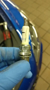

did you happen to see what the spark plug was gapped at?I just pull spark plug on cylinder 2 which is on the driver side. It was crack.

Personally. 91 octane on Map 2 doesn't sound like a good idea. Plus the factory gap size at 36 is making a recipe for disaster.![]()
Did you re-gap?91 is the highest octane I can get here where I live. When I log the drive it was hitting 16psi
Could be the constant misfire underload is destroying the plugs, unsure. Maybe the ECU is overcompensating, also unsure. Just speculating. In regards to map 1, I've noticed a trend with people running 91 are having misfire issues. Wheres people running 93 have not had any issues. Just speaking whats on my mind, I could be completely wrong lolIs a cracked plug something that can be cause by lower octane fuel with higher boost?
