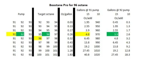

If it helps anyone, I did a little quick reference chart because I have access to 92 pump everywhere and that's pretty much it. So extrapolated a bit based on the above chart and just calc'd for getting 91 and 92 to minimum 96 (because 87, no).

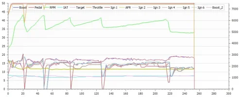

I just did few pulls after deleting the primary cats.
I have no clue about how many ponies the car makes, but it feels like a beast now! :laugh:
I attached one log.
Timings seem okay, but around the end, boost levels are quite high. Should I be worried?
What is the next step to be even faster? FMIC or Intake? :coffee:

Logs look great, no over boosting at all. Timing solid in all cylinders. Maybe the stock intake is helping keep boost down? I'd definitely try that next!
Ok, I will add this to my shopping list. Thanks! :thumbup:
Edit: I understood the wrong way, keeping stock intakes may be a good idea. :)
