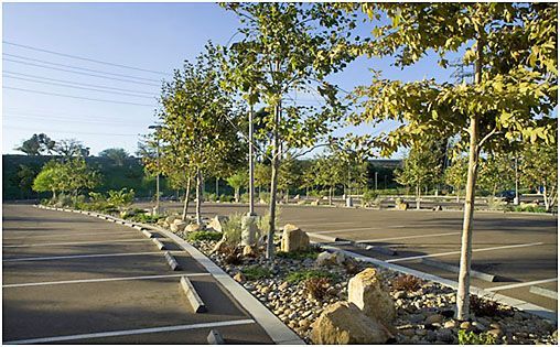

Community college parking lot on Sunday am.
The community college near me has raised islands of grass/trees between the parking spaces. something like this, so that is not an option.
