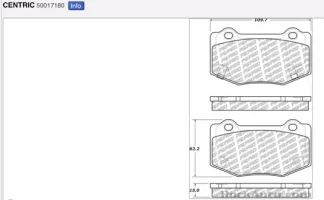

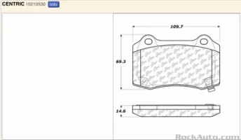

I’ve been looking for another car that uses our rear pads. I’m getting very close to finding a suitable set.
Our dimensions are
Stinger Rear Pad dimensions
103mm wide /
73.56mm tall
14.8 mm thick @ 4K miles
Below, are the dimensions of the front 13.4 rotor pad from a Genesis Track Package.
The Camaro/ATSV rear Brembo pad comes close too
I’d still like to get a bit closer in dimensions before buying some cheap pads to test.
Volvo is my latest lead, there are some possible compatible pads there too. Not through checking yet though.
Our dimensions are
103mm wide /
73.56mm tall
Can't see those images, too compressed and blurry.
Are those images from centric? I couldn't even select the g70 as an option their site.
