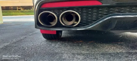

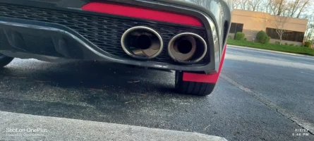

For the tips - most of us (haven't received mine yet) purchased them from Aliexpress. The drone wasn't even close to bad until I installed my Ark Secondary's yesterday, now it's noticeable so looking forward to the tips![]()
