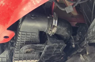

Wtf is that clamp?? I tried to put another hose clamp on instead since I was confused at that point of what kind of “clamp” I was looking at, and removed it without thinking twice. I replaced it with a T-bolt hose clamp and at 3k rpm, blew the drivers side charge pipe right out at that exact fitment location. I read the other discussions about this but thought I’d bring it back to light to see what others have done to fix that situation? I don’t want to wait for that clamp or buy it for like $80. Anyone know of good ways around this or am I stuck to being committed to buying that “clamp” from the dealership?
